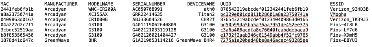

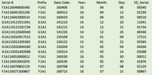

I was able to figure out the Date codes, and with the database that I am building I am slowly catching a lot of them. The tool Fios-F1nDr at least allows us to know the specific keyspace for a particular device. The date codes are also interesting because it gives us smaller blocks of devices that were manufactured together. I am hoping that with enough data the individual blocks might reveal more about the password generation. My scraping tool is working incredibly now, I've added another 30 entries to my database over the weekend. I did a much more general scrape this time and caught a lot of other devices. Verizon really seems to like these types of passwords though, because they use them across a variety of devices. This makes a “Verizon_” or “Fios-“ network much harder to crack since the device could be different. Since these also have a QR with all of the information, I will likely start scraping data on these too...if nothing else than to better inform Fios-F1nDr.
image_4192501959.jpgimage_4192501975.jpgimage_4192501982.jpgimage_4192502015.jpgimage_4192503801.jpgImage_4192500044.jpeg

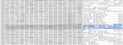

@soxrok2212 could you help me figure out why I can’t properly extract the firmware? In my previous posts, you can see that binwalk/unblob find ubi.img that contains 4 .ubifs files, one being ubifs-root. Extracting the root gives us the file system, but nothing in it (.txt, .html, .sh) is readable. Using ubi_reader to extract the ubifs does give us a Zlib error, which might be the issue. Referencing this error online, it seems to be when the compressed file is “corrupt”, so I am guessing there is some sort of encryption/obfuscation going on. Unfortunately this is still over my head, and I don’t know how to proceed.
I was going to attempt the NAND dump today using the glitch, but I quickly realized its on the underside of the board and requires me to disassemble the router further, so that will have to wait until I have the time to do that properly (I still want to use the router afterward).
I found text similar to what you posted in the downloaded firmware, I am guessing this is where it loads the information from NVRAM.
g3100_fw_2.0.0.6.bin -
VERIZON-G3100 ARCADYAN2018000001 G3100 R0A SA SA/01 ARVZ20180001 0000000000 1234567890 123456 0000222220 70 %d Si32260_LCQC_DE 000000000000000000000000000000000000

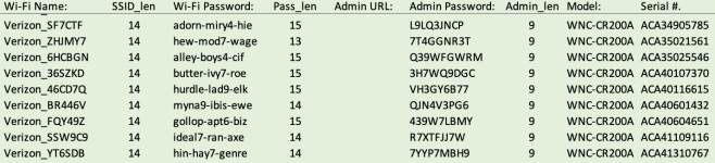

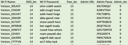

The CR1000A / CR1000B routers are manufactured by Wistron NeWeb Corporation. Unfortunately, the information is split into 2 labels so collecting complete entries is more difficult. The QR code contains does contain the MAC and serial at least. I updated my scraping script to include the images downloaded from each link, so now I can reference back to the actual listing when necessary. I think I will eventually put these all of these scripts on GitHub since posting updated versions here makes a lot of clutter.
('WIFI:S:Verizon_WP4ZXC;T:WPA;P:bug-aged6-noun;;ROUTER:M:CR1000A;S:ABV24234358;W:78670EA7007D;I:admin;P:WNV33WG6C;;1',)
Currently, the data set contains 86 entries for CR1000A / CR1000B!
SSID is Verizon_XXXXX where X is any char <A-Z><0-9> (This is slightly different from G3100/E3200)
SSID Passwords follow <word>-<word>-<word> with a single digit at the end of either the first 2 words, but never the third.
Admin Passwords are 9 characters that are <A-Z><0-9>.
From this sample we can gain some other info:
  • Password <word> are between 3-6 characters for SSID Password
  • We don’t currently see 0 or 1 in any of the SSID, SSID Password, or Admin Password.
  • There are several HW versions (103, 0.0.6, 0.0.7, 0.0.8, 0.0.A, 0.0.B, 0.0.C)
  • Shipped firmware ranges from 3.1.0.17 to 3.2.0.14
Somewhat surprising, in this small sample we have caught a good many Mac prefixes: 04.70.56, 1C.D6.BE, 58.96.71, 78.67.0E, 84.90.0A, AC.91.9B, BC.F8.7E, DC.4B.A1
Serial numbers are always 11 digits and start with 2-3 letters, followed by digits. If we compare the MAC/Serial difference like before, we see these change in steps of 7. So we should be able to calculate the serial numbers once I figure out how they’re blocked together.

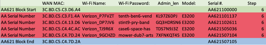

Ok here we go with this weeks update! Since we are targeting many more devices now, I spent this week working on my Facebook scraping script. FB is a bit trickier to scrape because they load pages dynamically, and don’t follow normal naming conventions to make it a bit harder to do. Fortunately those are overcome with a bit of effort, and with AI and I helping each other a bit, I finally have something I am happy with. So now we have a bunch of new entries to the database, we’re up to 727 unique entries!
Updated Data Set: router_data_FULL_050325.xlsx
We have added 36 new G3100/E3200, so as always here are the Fios-F1nDr stats:
Before:
Correct - 22 (61%)
Incorrect - 7 (19%)
unknown block - 0 (0%)
Unknown device - 4 (11%)
Not Enough Data - 3 (8%)
After:
Correct - 32 (89%)
Incorrect - 4 (11%)
Unknown Device 0 (0%)
Not enough data 0( 0%)
Check that out, we’re making some progress! The 4 that were incorrect are outliers. We now have 202 Date Codes. that range from 4/29/19 to 10/28/24.

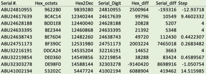

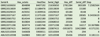

Some more good news, we have collected enough entries that we can determine the 11-digit serial blocks! These are always E3200 devices, using the last 5 digits as the incremental serial we can see the steps are in increments of 6. All of the E3200 have had a step of 6 so far. This info helps us unlock a lot of the DC.F5.1B and 74.90.BC space that I had kind of ignored previously 😀 . Fios-F1nDr needed a minor update to calculate these properly, but I have a GitHub account now so hopefully I can get all of the scripts uploaded by next update.
As I pointed out before, we are starting to have a good many entries for the same date codes. Block 190813 now has 9 entries! So I will soon look at those closer and see if I can catch any patterns. I still haven’t had a chance to glitch my device, but I found some interesting artifacts in the g3100_fw_2.0.0.6.bin and e3200_fw_3.1.1.17.bin. I haven’t really poked around in any of the other firmware yet. I will circle back to all of that eventually, so many things to do...

@Sardukarrr we can certainly try to crack how the SSID is created, but from what I see these devices report the proper MAC address during the handshake capture. So for now, use that as a reference. Your post in this thread encouraged me to go back and look at the keyspace again, it turns out that we now have enough data to shrink it a bit! @drsnooker for G3100/E3200 there are multiple algos depending on the date of manufacture. Here is an update to my OP.
From our dataset we can gain some info on the G3100/E3200 key space:
  • MAC address Block 04.A2.22.00.00.00 to 04.A2.22.D3.FF.2F are the oldest and ALWAYS have 16 character passwords
    SSID is Fios-XXXXX where X is any char <a-z><A-Z><0-9>
    SSID Passwords follow <word><number><word><number><word> format (ex: room50cleft78dry)
    Admin Passwords are 16 characters and follow a <word><number><word> format (ex: bedeck183magenta)
    <word> is between 3-7 characters long, <number> is ANY 1-4 digits
    *Suprisingly, this “algo” seems it would be the hardest to crack, but they quickly drop it for some reason.

The device of the week is the ASK-NCQ1338 family, which includes ASK-NCQ1338, ASK-NCQ1338E, ASK-NCQ1338FA. I couldn’t find much info on the differences, but I think the “E” is an extender and I know the “FA” is the newer model. These devices are manufactured by Askey Computer, and can be considered the sister device to the ARC-XCI55AX. I forgot to mention last week, but both the ARC-XC155AX and ASK-NCQ1338 are 5G routers that use cell signal to provide internet. The QR code provides a lot of useful information, including the MAC which unfortunately isn’t printed on the sticker. Similar to the ARC, the QR contains both a date code and the IMEI. The QR also has the ICC ID, which means we can easily collect that with the other data. Something strange though, the last item in the QR code is P: <6 digit number>. Does anyone have an idea what this might be since WPS is 8 digits?
('WIFI:S:Verizon_J7JYV9;T:WPA;P:enact-ace9-rang;;ROUTER:M:ASK-NCQ1338FA;S:ABB30107759;D:20230117;F:222656;I:admin;P:79T649KNV;E:356649621448392;C:89148000008863050351;B:FC1263A32908;P:937181;;1',)
Currently, the data set contains 107 entries for ASK-NCQ1338 models!
The SSID and passwords follow the same pattern seen in the CR1000A/B and ARC-XCI55AX
  • SSID passwords are13-15 characters long
  • Password <word> are between 3-5 characters for SSID Password (haven’t seen a 6 character word yet)
  • We don’t currently see 0, 1, 2, 5, 8 in any of the SSID, SSID Password, or Admin Password.
  • HW versions are not printed on the device or QR code
  • Shipped firmware ranges from 212331 to 222656
The MAC addresses that we see for this device are 2C.EA.DC, 4C.AB.F8, 88.DE.7C, A4.97.33, FC.12.63.
Serial numbers are always 11 digits and start with 2-3 letters (AA, AAM, or ABG), followed by 8 digits. If we compare the MAC/Serial difference like before, we see these change in steps of 4. Hopefully I will be able to use the IMEI or Serial # to back calculate the MAC address for images that we can’t read the QR code. All of the 11 digit serials are very similar across the various models in this thread, so again this is a case where one device can inform us about another.
From the device teardown, we see that the CPU is a Qualcomm Hawkeye IPQ8072A Quad Core ARM 64 bit A53 2.2GHz processor. The memory is Samsung K4A8G165WB-BCRC 8Gb DDR4 1200 MHz and Samsung KLM8G1GETF-B041 8GB eMMC NAND.
I wasn’t able to find any firmware online. However this device also has the hidden compartment. I think I read it was for the SIM card on this device, but the ARC-XCI55AX has an eSIM and USB-C here.

This week’s device spotlight is the WNC-CR200A, which like the CR1000A is also manufactured by Wistron NeWeb Corporation. This is a 4/5G router similar to the ARC-XCI55AX and ASK-NCQ1388. They didn’t hide the USB-C port on this one. Sadly, neither the QR code or the sticker have the MAC address. It does include the date code and other important information however.
('WIFI:S:Verizon_7K3WCX;T:WPA;P:hearth-bot6-sir;;ROUTER:M:WNC-CR200A;S:ACA33004690;D:20230816;P:7JW9YXRKP;E:357473871131817;C:89148000009539565590;;2',)
Currently, the data set contains 41 entries for WNC-CR200A models!
The SSID and passwords follow the same pattern seen in the CR1000A/B and ASK-NCQ1338
  • SSID passwords are 13-15 characters long
  • HW version is 0.0.5
  • Shipped firmware is Unknown
The serial number is 11-characters, starting with ACA followed by 9 digits. Since the MAC address is unknown I compared the serial to the IMEI and ICCID. Although both of these appear to mostly follow the date code sequentially, I was unable to find any kind of direct relationship. We don’t have a ton of entries for this device, but it's possible that we could figure out the relationship based on other devices.
From the device teardown, we see that the CPU is a Qualcomm Hawkeye IPQ8072A Quad Core ARM 64 bit A53 2.2GHz processor, which is the same as the ASK-NCQ1338. I think the memory is the two chips labeled "2CR77 D8BPK” but I was unable to find any data sheet for this. I wasn’t able to find any firmware online.

Everyone join the celebration, we finally hit a few milestones this week. There are now over 1000 unique entries in the database, and over 500 entries for the G3100/E3200! The past two weeks I’ve focused heavily on scraping images from the search engine dorks that I’ve posted. Somehow I overlooked that these searches also turn up several links that may lead to old listings (for FB and offerup). So now I am collecting the links too and scraping those listings as well. It was a silly thing to overlook, but I’m happy I caught it because we gathered a ton of new images. I’ve added 92 new entries for the G3100 / E3200, which up to 555 now!
Updated Data Set: router_data_FULL_052325.xlsx
Of course we have to test the new entries with Fios-F1nDr
Before:
Correct - 57 (62%)
Incorrect - 29 (32%)
unknown block - 4 (4%)
Unknown device - 2 (2%)
Not Enough Data - 0 (0%)
After:
Correct - 84 (91%)
Incorrect - 8 (9%)
Unknown Device - 0 (0%)
Not enough data - 0 ( 0%)
I looked back through the past updates and this is the highest % initially correct so far! As always there are some outliers, but this week I actually managed to sort out some of the outliers. With enough of them in the same date block, I was able to see that some belonged in their own block. Once separated, both blocks calculated correctly again. Awesome! There are now 235 Date Codes.
Now that I had some sort of dictionary, I spent some of this week collecting captures for these devices. I had been using older software to capture, but now I have hcxdumptool working correctly. Using hcxpcapngtool -D on the captures gives us the device info. We see that the correct MAC, Model, and Serial are broadcast in the packet... which makes calculating the serial like I have been doing with Fios-F1nDr completely useless :cry:. The good news is that separating the entries by Date Codes is still useful, and I will have more time to look into something else haha.

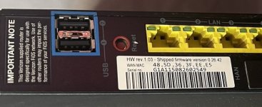

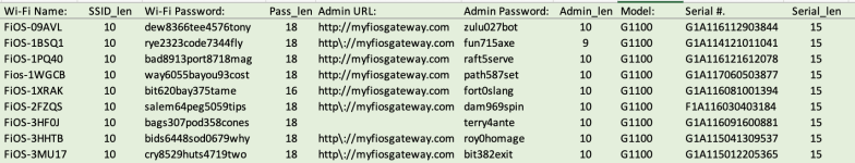

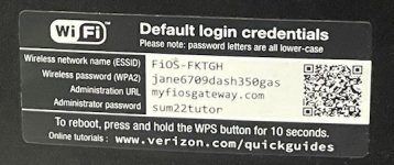

The odd GreenWave device above is the G1100, which happens to be our device of the week!
The G1100 is manufactured by Greenwave. This device is an older model that was distributed for a good number of years. As far as I can tell this is the first device to use the QR code on the sticker. The information contained in the QR code changes a few times during production, but it’s fairly basic. Unfortunately the MAC address isn’t contained in the QR, but it is included on a different sticker. Unfortunately I have not been collecting / connecting the second sticker to the first, but that will change hopefully. It’s kind of funny that we can see that they messed up the URL in the QR code to read incorrectly "http\\://myfiosgateway.com”, which does eventually get fixed later on.
('WIFI:S:FiOS-FKTGH;T:WPA;P:jane6709dash350gas;;ROUTER:S:G1A115082602549;U:http\\://myfiosgateway.com;I:admin;P:sum22tutor;;1',)
Currently, the data set contains 136 entries for G1100 models!
SSID is FiOS_XXXXX or Fios_XXXXX where X is any char <A-Z><0-9> (The FiOS prefix is unique to this device)
SSID Passwords follow <word><number><word><number><word> (I did catch 2 entries that are <number><word><number><word>)
Admin Passwords are 8-10 characters and follow <word><number><word>
  • SSID passwords are 16-18 characters long (16 characters is rare, only 3 entries so far)
    • These appear to be the most complex out of all of the devices.
  • MAC Prefixes <Currently Missing>
  • HW version <Currently Missing>
  • Shipped firmware <Currently Missing>
The serial number is 15-characters, starting with F1A, G1A, or S1A followed by 12 digits. Looking at the serial #, we see that they contain a Date Code (2-Digit Year, 2-Digit Month, 2-Digit Day) similar to the G3100/E3200. In the serial (G1A115082602549) the first 4 characters is the Prefix, the next 6 characters is the Date Code, and the last 5 is the 5-Digit incremental serial. We can verify this because the Month column is never > 12, and the day is never > 31 and is only ever 31 on a month with 31 days. The years fall between 14-19.
From the device teardown, we can’t see much. However, this video on YouTube does a better job and tells us the CPU is a ARMv7 Cortina WPCS7542E A1 dual core 750mhz. Sadly, I can’t identify the memory from either source. There is a GitHub page that has firmware available, as well as info on how to root the device.
