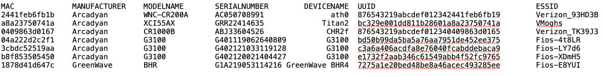

uuid=$(echo "$macaddr" | sed 's/://g')
uuid_config="uuid=87654321-9abc-def0-1234-$uuid"
It looks like for the CR1000A/B we just append the MAC address (with : removed) to the end of this string? Let’s check the capture we have..
MAC: 0409863d0167 UUID: 876543219abcdef012340409863d0165
Hey that’s cool! The UUID is as expected, but 2 off of the broadcast MAC. Looking at the firmware a bit more we see why.
 option mac_address '78:67:0E:33:2F:BE'
    option mac_address_eth '78:67:0E:33:2F:BF'
    option mac_address_wlan1 '78:67:0E:33:2F:C0'
    option mac_address_wlan2 '78:67:0E:33:2F:C1'
    option mac_address_wlan3 '78:67:0E:33:2F:C2'
    option mac_address_moca_lan '78:67:0E:33:2F:C3'
    option mac_address_iot1 '78:67:0E:33:2F:C4'
The MAC broadcast in the WiFi packet is for wlan1, but the UUID is based off what I’ll call the “real” MAC. This also explains why this model has “steps” of 7 when we compared the MAC HEX/Serial. Each devices actually takes up 7 MAC addresses!

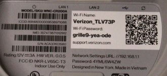

The ASK-NCM1100 and ASK-NCM1100E is a 5G NR Sub 6 WiFi 7 Router manufactured by Askey Computer. The device teardown doesn’t show much, and I couldn’t find the relevant info through other searches. I didn't find any firmware either. The sticker doesn’t offer much info, but the QR code does including the MAC, ESSID, ICCID, and Date. Like the ASK-NCQ1338 these have the 6-digit pin that I still don’t know what it’s for. There are currently 17 entries for these devices
('WIFI:S:Verizon_9RGMN3;T:WPA;P:gear9-drub-arc;;ROUTER:M:ASK-NCM1100;S:ACR42416174;D:20240708;P:7LZXTZ9YJ;E:354784270372742;C:89148000010537500092;B:3888710BF498;P:963160;;1',)
SSID is Verizon_XXXXXX where X is any char <A-Z><0-9>
SSID Passwords are 14 or 15 characters and either <word><number><word><number><word> format (ex: glance5ane3pore)
or <word>-<word>-<word> with a single digit at the end of the first or second word (ex: dub6-grim-twain)​
Admin Passwords are 9 characters <A-Z><0-9> format (ex: 4HDHGBV9R)
MAC Prefixes 38.88.71

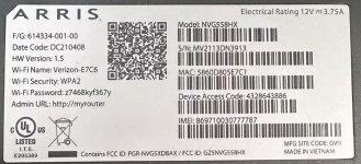

The NVG558HX is a “fixed broadband gateway” manufactured by ARRIS. The device teardown is also complete shit. Thankfully the sticker and has all of the info we want. These devices have the least secure passwords that we have encountered. There are currently 4 entries for these devices.
('WIFI:S:Verizon-1776;T:WPA2;P:j3337hg43nrs;;ROUTER:M:NVG558HX;S:MV2134DN3756;D:20210827;F:9.4.0h1d43;I:admin;P:5968372461;;1',)
SSID is Verizon-XXXX or where X is hexadecimal <A-F><0-9>
SSID Passwords are 12 characters <a-z><0-9> (ex: nkn35vnjrm5g)
Admin Passwords are are 10 characters <0-9> format (ex: 5943714157)
MAC Prefixes Unknown

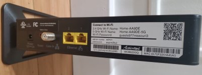

The WCB6200Q is a network extender manufactured by Actiontec. The device teardown shows a Broadcom chipset, but I am unable to read the CPU model number. All of the typical info is on the sticker and QR code. There are currently 23 entries for these devices.
('WIFI:S:Home-AA9DE;T:WPA;P:guests977missouri3;;EXTENDER:M:WCB6200Q;S:GWXA8140802285;X:Home-AA9DE-5G;P:expire2but;C:70F2201A45A0;;1',)
SSID is Home-XXXXX or where X is any char <A-Z><0-9> I also picked up 1 Actiontec-XXXX where X is a digit <0-9>
SSID Passwords are 17 or 18 characters and <word><number><word><number>(ex: nevada635gauzy3929)
I also caught several entries that are <number><word><number><word> (ex: 738adoring069owned)
Admin Passwords are are 10 characters <word><number><word> format (ex: drip6smoky)
MAC Prefixes 4C.8B.30, 10.78.5B, 70.F2.20

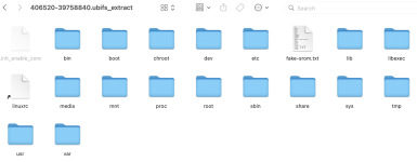

g3100_fw_2.0.0.6.bin -
VERIZON-G3100 ARCADYAN2018000001 G3100 R0A SA SA/01 ARVZ20180001 0000000000 1234567890 123456 0000222220 70 %d Si32260_LCQC_DE 000000000000000000000000000000000000
NAND Dump
VERIZON-G3100 ARVZ201800001 0000000000 G402121100103771  1  G3100  G3100  ROA  SA  SA/01  450  ""  70 SA  SA/01  were4-caw-cruet  123456 0000222220  70  %d  Si32260_000000000000000000000000000000000000  6BNF9CZG7  123456  00002222123456  Verizon_79ZJ3C

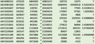

We managed to jump from 4 to 54 entries for the NVG558HX, so now they have their own sheet in the database. We already saw that the SSID is generated from the last 4 characters of the MAC, but we already caught a SSID collision!
I mentioned last post that these devices have the least secure passwords that we have encountered. This was based on the 12 character length, <a-z><0-9>. However, I failed to check the calculations. For each position, there are 26 characters +10 digits = 36 possible choices. The number of possible password combinations is 36^12 = 4,738,381,338,321,616,896 which is uncrackable. Now that we have more entries, we see some characters are omitted (a,e,i,l,o,u,0,1) = 28 possible choices. 28^12 = 232,218,265,089,212,416 which is significantly smaller, but still uncrackable :cry:.

This week’s scrape did match 2 VERY similar passwords however. Certainly this can’t be a coincidence?
We caught a WNC-CR200A with the WiFi password grille9-yea-ode
We also have a CR1000A with the WiFi password yea-grille9-ork

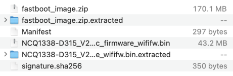

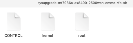

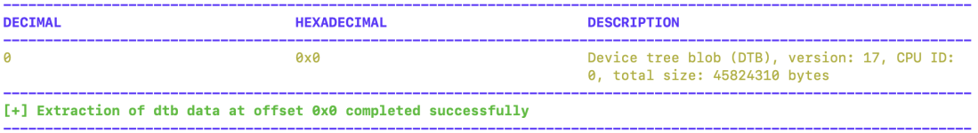

We also found firmware links for the ASK-NCQ1338, I was able to figure out that the firmware naming is in the format ASK-NCQ1338_<current version>_<new version>.bin. Since I already collected the firmware version in the database, It was easy to enumerate other links! There were a few links missing files, I’m guessing that there is probably another firmware version in between. I could try fuzzing to find them, but I don’t think it’s entirely necessary at the moment. These links are accessible even if you’re not on the Fios network.
https://cdn2.vzwdm.com/ASK-NCQ1338_212331_212431.bin
https://cdn2.vzwdm.com/ASK-NCQ1338_212431_213231.bin
https://cdn2.vzwdm.com/ASK-NCQ1338_213231_214322.bin
<missing>https://cdn2.vzwdm.com/ASK-NCQ1338_214322_214727.bin
<missing>https://cdn2.vzwdm.com/ASK-NCQ1338_214727_220745.bin
<missing>https://cdn2.vzwdm.com/ASK-NCQ1338_220745_220847.bin
<missing>https://cdn2.vzwdm.com/ASK-NCQ1338_220847_222146.bin
<missing>https://cdn2.vzwdm.com/ASK-NCQ1338_222656_222746.bin
Running binwalk on the firmware, it pops right open! I haven’t found anything too exciting, but I still need to poke around more.

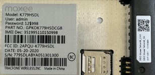

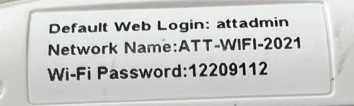

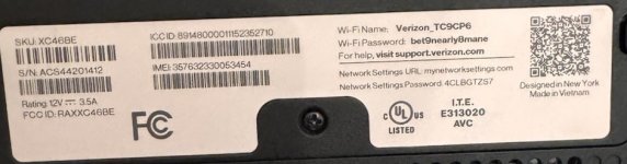

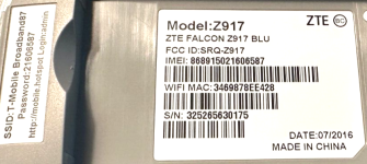

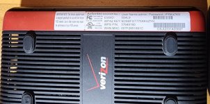

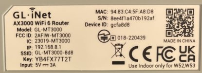

I wanted to highlight some of the devices that get caught in the QR scrape but are out of scope for this thread. Maybe sometime I will have some time to check them out further. I have seen a dozen or so devices, but most of the time the QR only contains the SSID / Password. Here are a few that are a bit more interesting.
The QR code has the SSID, WiFi Password, Model, Serial, and Admin password.
('WIFI:T:WPA;S:CenturyLink2155;P:qtu72q46dmj5r4;www.centurylink.com/home/account/installmyapp.html;C4000LG;C4000LG2034582155;192.168.0.1;admin;Ux5sc7Ta;',)
The QR code is structured a bit differently, but contains all of the info that’s on the sticker.
('S/N:50D10M2BD07603\rMAC:80691A6ECE42\rName:_VelopSetupE42\rPassword:ktxt0dhzrj\rRecovery Key:67502',)

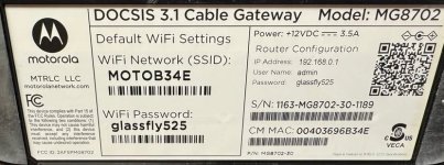

The QR code has the SSID, WiFi password, MAC, Serial, Model
('WIFI:T:WPA2;S:MOTOB34E;P:glassfly525;;DEVICE:M:00403696B34E;S:1163-MG8702-30-1189;T:MG8702;;',)
The QR code is missing the Serial and IMEI

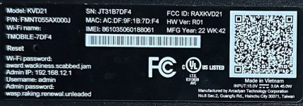

('{"ID":"TMOBILE-7DF4",\n"KY":"award.wackiness.scabbed.jam",\n"U":"admin",\n"P":"wasp.raking.renewal.unleaded",\n"BT":"TMOBILE-7D-F4",\n"PN":"FMNT055AX000J",\n"23S":"ACDF9F1B7DF8"}',)
Not much info in the QR code, but the sticker contains everything we would expect. These passwords are 8 characters all digits and very easy to crack as seen here and on WPA-SEC.
('WIFI:T:WPA;S:TP-Link_BB4E;P:43582969;;',)

We have a new device this week, the CME1000. I had been aware of this device for a while, but the sticker doesn’t have much information and I hadn’t found an image with a readable QR code yet. However, when we can read the QR code it has all of the relevant information. There is no device tear down, though I would like to see inside just for fun
('WIFI:S:Verizon_MP6P3L;T:WPA;P:oak3-spigot-pay;;EXTENDER:M:CME1000;S:AAB21103062;B:08B05532DB18;P:NKFYQD94G;;2',)

Then we can decrypt the firmware with the keys using this command
Rich (BB code):
gpg --output <decrypted_output_file> --decrypt <encrypted_input_file>
gpg --output decrypted_bhr4_stepstone_release_1.2.0.36.98.0_firmwareupgrade.bin.signed --decrypt bhr4_stepstone_release_1.2.0.36.98.0_firmwareupgrade.bin.signed
Finally we extract the decrypted firmware with
binwalk -Me decrypted_bhr4_stepstone_release_1.2.0.36.98.0_firmwareupgrade.bin.signed
And this is where I have been stuck... binwalk only extracts a system.dtb and I am not really sure what to do from there. It took me way too long to realize that the decrypted firmware extracts cleanly with unblob!
unblob decrypted_bhr4_stepstone_release_1.2.0.36.98.0_firmwareupgrade.bin.signed

Note: Here MACS is what I’ve been calling “steps” throughout the thread. It’s calculated by comparing the differences in MAC address vs differences in Serial number. This results in a whole number that indicates how many MAC addresses each devices occupies.
Model: ARC-XCI55AX
Manufacture: Arcadyan
Device: Titan2
Serial Prefix: ABU GRR
Serial Length: 11
MACS: 4
MAC Prefix: 04:09:86 04:70:56 18:58:80 4C:22:F3 54:B7:BD 74:90:BC 84:90:0A 84:A3:29 8C:83:94 A8:A2:37 AC:B6:87 BC:F8:7E C0:D7:AA C8:99:B2 DC:F5:1B F4:CA:E7
UUID: All entries are bc329e001dd811b28601XXXXXXXXXXXX, where X is 1 less than the broadcast MAC Address
EX: 04098647eaa3 = bc329e001dd811b2860104098647eaa2
SSID: Verizon_XXXXXX

Serial Length: 12
MACS: Unknown
MAC Prefix: 64:FF:0A 88:5A:85 B8:9F:09 44:E4:EE
UUID: All entries are 876543219abcdef01234XXXXXXXXXXXX, where X is 2 less than the broadcast MAC Address.
EX: 64ff0a558556 = 876543219abcdef0123464ff0a558554
SSID: Verizon-5G-Home-XXXX or Verizon-LRV5-XXXX
Model: NVG558HX
Manufacture: Commscope
Device: <same as Serial Number>
Serial Prefix: MV2
MACS: 12
MAC Prefix: 20:F3:75 58:60:D8 8C:5A:25 E4:F7:5B
UUID: Appears to be random
SSID: Verizon-XXXX

Serial Prefix: GWXA GWXB MWXB (identified from image scrape data)
Serial Length: 14
MACS: 16 (calculated from image scrape data)
MAC Prefix: 10:78:5B 4C:8B:30 70:F2:20
UUID: ALL entries show a single UUID d96c7efc2f8938f1efbd6e5148bfa812
SSID: FiOS-XXXXX or Fios-XXXXX
Note: This device is an extender only, so it is broadcasting the base SSID/Password
Model: WNC-CR200A - 327 entries
Device: ath0 or ath1
Serial Prefix: ACA AC0
Serial Length: 11
MACS: 4
MAC Prefix: 58:96:71 24:41:FE AC:91:9B DC:4B:A1
UUID: All entries are 876543219abcdef01234XXXXXXXXXXXX, where X is 1 less than the broadcast MAC Address
EX: 589671080e92 = 876543219abcdef01234589671080e91
I noticed that the new model from last week, the CME1000 has the device name CHR2tte, which looks very similar to CHR2f (CR1000). So I added it to the firmware fuzzing script and we found the firmware for it!
https://cpe-ems34.verizon.com/firmware/chr2tte_fw_3.2.0.9.bin
https://cpe-ems34.verizon.com/firmware/chr2tte_fw_3.2.0.11.bin
https://cpe-ems34.verizon.com/firmware/chr2tte_fw_3.2.0.12.bin
It seems to extract ok with unblob, leaving us with 3 files. Unfortunately the root is LUKS encrypted and this is where I’m stuck.
cat CONTROL
BOARD=mt7986a-ax8400-2500wan-emmc-rfb-sb
file kernel
Device Tree Blob version 17, size=21649753, boot CPU=0, string block size=194, DT structure block size=21649160
file root
LUKS encrypted file, ver 1 [aes, xts-plain64, sha256] UUID: 8856759b-9e7d-41db-b48e-7f1deb53cbb0
binwalk -E chr2tte_fw_3.2.0.9.bin
binwalk -Me chr2tte_fw_3.2.0.9.bin
DECIMAL HEXADECIMAL DESCRIPTION
256 0x100 POSIX tar archive, file count: 4
Analyzed 1 file for 85 file signatures (187 magic patterns) in 173.0 milliseconds
[+] Extraction of tarball data at offset 0x100 completed successfully
sysupgrade-mt7986a-ax8400-2500wan-emmc-rfb-sb/kernel
0 0x0 Device tree blob (DTB), version: 17,
CPU ID: 0, total size: 21649465 bytes
[+] Extraction of dtb data at offset 0x0 completed successfully
Analyzed 5 files for 85 file signatures (187 magic patterns) in 1.5 seconds

@RealEnder great job with the imeigen, I will have to look at the Verizon/Fios IMEIs. ZerBea posted on the hashcat thread. I haven't had a chance to see which devices these are yet.
"You can also add "T-Mobile Broadbandxx" to your list: PSK pattern = ?d?d?d?d?d?dxx"
@Nickthesail0r unfortunately, other than having the MAC prefix DC:F5:1B the devices don’t seem to share much in common. I couldn't find many images for these devices. Since they share the prefix with the Verizon devices, they are slightly interesting to me, so attached below is the hcxpcapngtool -D shared from WPA-SEC. You’ll see there are a wide variety of devices that share this space, including your COSMOTE- devices. Fios-F1nDr has been updated to differentiate between ARC-XCI55AX, CR1000, CME1000, E3200 for this MAC prefix, so thank you for drawing my attention to this.
This week I was able to add 63 new entries to the password database.
Updated Data Set: router_data_FULL_072325.xlsx
The Dataset now contains:
G3100/E3200 - 697 entries
CR1000 A/B - 177 entries
ARC-XCI55AX - 143 entries
ASK-NCQ1338 - 165 entries
WNC-CR200A - 62 entries
G1100 - 374 entries
NVG558HX - 67 entries
Other - 143 entries
Total - 1828 entries
We caught a new device too, the XC46BE, which is also manufactured by Arcadyan. The device teardown shows a variety of chips. I believe the Mediatek MT6990V is the ARM CPU, but I couldn’t find much info. The device QR code and sticker provide a great bit of info.
('WIFI:S:Verizon_TC9CP6;T:WPA;P:bet9nearly8mane;;ROUTER:M:XC46BE;S:ACS44201412;D:11-26-2024;F:3.4.0.5;P:4CLBGTZS7;E:357632330053454;B:3806E60264DD;;1',)
I found the device using the data from WPA-SEC, here is the info broadcast in the packet. The device is the DRAGON :cool:
2037f022cf12 Arcadyan XC46BE ACS50602760 DRAGON bc329e001dd811b286012037f022cf10 Verizon_BJ3F49
Model: XC46BE
Device: DRAGON
Serial Prefix: ACS
MACS: Not enough Info
MAC Prefix: 20:37:F0 38:06:E6
UUID: All entries are bc329e001dd811b28601XXXXXXXXXXXX, where X is 2 less than the broadcast MAC Address
EX: 3806e6801442 = bc329e001dd811b286013806e6801440
SSID: Verizon-XXXX
The 3 password entries I was able to find show that The SSID password is 15 characters, and follows a new format <word><digit><word><digit><word>. So far, these passwords are comprised of a 3-letter, 4-letter, and 6-letter word with single digits. The admin password is 9 character alphanumeric as we’ve seen with a lot of the other devices.

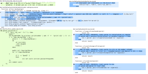

The CSG m106 was also caught in the scrape, which is some sort of Verizon device though it doesn’t have the Verizon/Fios SSID. There QR code is just a link to the CSG website. However, the password is 8 character hex that is actually just the end of the serial number. Unfortunately, this device does not broadcast any ESSID information. I did the normal eBay, FB, OfferUp scrape and caught 19 entries. The serial numbers appear to be a a random 16 character hex, possibly a truncated hash. So I had a script try various user input, as well as Unix Epoch time against the password. There are several hashes that produce the password, but none that produce the full serial, so I suspect they are false positives. @RealEnder found the firmware (https://connectcsg.com/pages/firmware-updates), which extracts nicely...so I checked to see how the SN is being generated.
In the file gl_init we see
uci set glconfig.general.factory_mac=$(get_default_mac_with_colon)
uci set glconfig.general.factory_sn=$(get_default_sn)
 ssid=`uci get glconfig.general.factory_mac | awk -F ":" '{print $(NF-1)$NF}'`
uci set wireless.@wifi-iface[$index].ssid="CSG-${ssid}"
 key=`uci get glconfig.general.factory_sn | awk '{print substr($0,9)}'`
So we see The SSID is generated from the MAC, and the key is last 8 characters of the factory_sn. Unfortunately the factory_sn is pulled from NVRAM.
The data collected for CSG m106 all have the MAC prefix 94:83:C4, so I checked there in the WPA-SEC data. There are not any CSG entries since they don’t broadcast the information, however there are several GL-SFT1200 that overlap the address space. The firmware for this device is also available (https://dl.gl-inet.com/router/sft1200/stable), extracts cleanly, and is very similar to the CSG m106 with some minor vendor changes. In gl_init file for both firmware we see
ssid_prefix="GL-"${model}
uci set wireless.@wifi-iface[$index].key=goodlife
As the image above shows, devices with the SSID GL-<model> have the default password “goodlife”. The firmware shows other models this applies to AR300M, AR750, B1300, B2200, E750, MT750, S200, S1300, X750, X1200
One of the devices that the default password doesn’t work on is the GL-MT3000 and GL-MT6000, which we see has a 10 character alphanumeric password :frown:. We have the firmware for this device too (https://dl.gl-inet.com/router/mt3000/stable and https://dl.gl-inet.com/router/mt6000/stable). The password seems to be pulled from NVRAM.
wifi_password=`lua /usr/bin/get_unique_password.lua`
lfactory.get_unique_password()
But the guest networks may still have the default password “goodlife"
set wireless.$1.key=goodlife
set wireless.$guest.device="$device"

Model MR1100
SSID ATT-WIFI-XXXX
MAC prefixes 10:0C:6B, 44:A5:6E, 8C:3B:AD, CC:40:D0
This device has a 8 mixed case alphanumeric password, but they also have a huge weakness. The last 4 characters in the SSID are part of the password. The first character (SSID) is the 2nd character (password), similarly the 2nd character (SSID) is the 4th character (password), the 3rd character (SSID) is the last character (password), and the 4th character (SSID) is the 6th character (password). So ATT-WIFI-1234 would have a password X1X2X4X3. I have attached data on 10 of these devices below as a proof of concept. If I were to collect more data we could possible reduce the character space further, but for now there are 14776336 possible combinations. Using the image above as our example, this hashcat command should crack it.
hashcat -m 22000 -a 3 MR1100_hash.txt -1 '?l?u?d' '?1J?12?13?1p'

Model Z917
SSID T-Mobile BroadbandXX
MAC prefixes 34:69:87
IMEI TAC 86891502
Password is the last 8 digits of IMEI, SSID has last 2 digits.

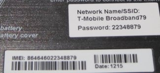

Model MF61
MAC prefixes Unknown
IMEI TAC 35578604
Model K779HSDL
SSID Moxee HotspotXX
or Moxee TetherXX
IMEI TAC 35890230 or 35199511
Model MF279
SSID ATT-WI-XXXX
Password is 8 digits, but not related to IMEI

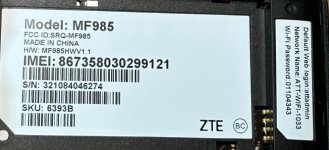

Model MF923
SSID ATT-WIFI-XXXX
Model MF985
SSID ATT-WIFI-XXXX

However I found out that at least two more models besides Model NOK 5G21 that use SSID TMOBILE-XXXX with a different password scheme.
