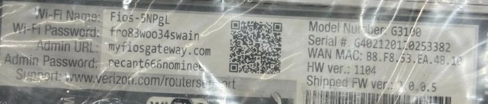

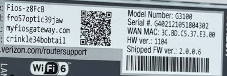

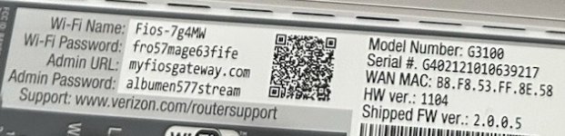

This week we caught an interesting partial password collision of fro57 for the G3100
Nothing else seems to match up so I am not sure it really means anything, since we also have fro83 and fro38 for the same device.

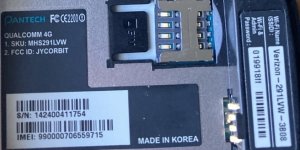

I also looked through more of the Verizon hotspots. Most of them don’t show a default password, but I did find a few models that do!
Model 291LVW
SSID Verizon-291LVW-XXXX
Password is 8 characters HEX

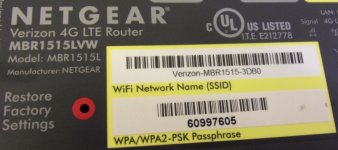

Model MW513U
SSID Verizon-MBR1515-XXXX
Password is 8 digits

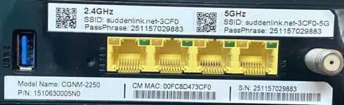

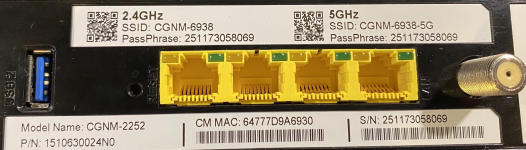

Model Hitron CGNM-2250 and CGNM-2252
SSID CGNM-XXXX,
sudden link.net-XXXX, SHAW-XXXX
The CGNM-XXXX SSID is for models 2250 and 2252, but most have already been found on WPA-SEC. However, the examples I found the password always starts with the prefix 2511. The 5th digit is 5,6, or 7 and the 7th digit is almost always 0, but I did capture a password with 1 in that position. This reduces the keyspace to much lower complexity.
hashcat -m 22000 -a 3 CGNM.txt -1 567 -2 01 2511?1?d?2?d?d?d?d?d
The SSID suddenlink.net-XXXX is also for this device and follows the same pattern, many of these have not been cracked yet. Sometimes they start with 2441 instead of 2511, but I believe there is also another, much harder default with these SSIDs as well.
hashcat -m 22000 -a 3 sdlink.txt -1 567 2441?1?d0?d?d?d?d?d

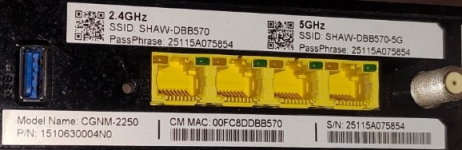

The SSID SHAW-XXXXXX is also for this device and follows the same patterns. However this and the CGNM-XXXX may have have upper case hex characters in the 6th,7th, or 8th position in the password. Surprisingly though, I was unable to crack any of this SSID.
hashcat -m 22000 -a 3 SHAW6.txt -1 567 2511?1?H?H?H?d?d?d?d

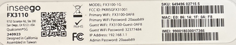

Model inseego FX3110
SSID FX3100-XXXX
password is 8 character HEX lowercase

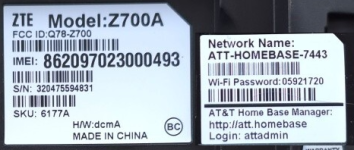

Model ZTE Z700A
SSID ATT-HOMEBASE-XXXX
password is 8 digits, but not related to IMEI
