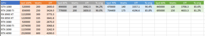

I compiled the below, which shows Watt efficiency against WPA speed for numerous cards. I also have 80%, 70% and 60% POWER efficiency speeds. Note 60% is slower, but more efficient. Another note is the GPUs run a lot cooler when reducing the POWER (obviously). Much better way to run jobs I think. More efficient and cooler. I never run at 100% POWER any more. Doing this also extends the lifespan of the GPUs, as less thermal damage due to over-heating.
The WPA speeds are RAW, so not using kH/s. Also, "Eff" = Efficiency, which is: (Speed / Watts) = Eff. The "% orig" is the speed from the %100 original. At 60% power, I get 81.2% of the original speed for my RTX 2080 Ti.
Shows how CRAP the RTX 3000 series cards were. They are beaten by my old RTX 2080 Ti on efficiency.
The GTX 4090 I'm not sure on actually wattage, so it's at 450 watts for now. Even at 600 watts, it scores 4200 efficiency, still beating the others. If you can give me actual GPU speeds and wattage, I'll update but please note, I want RAW speeds, no OVER-CLOCKING!

I compiled the below, which shows Watt efficiency against WPA speed for numerous cards. I also have 80%, 70% and 60% efficiency speeds. Note 60% is slower, but more efficient.
2371 mhz and 325 watts

Good information, Blandy
Agree hash per Watt is the most important for running costs
