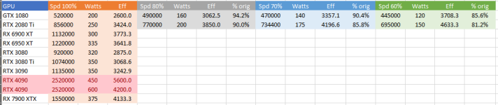

Anyone got the AMD RX 7900 XT and XTX WPA speeds?
Also updated my GPU speed comparison text above with this. Worth reading!
"Another note is the GPUs run a lot cooler when reducing the POWER (obviously). Much better way to run jobs I think. More efficient and cooler. I never run at 100% POWER any more. Doing this also extends the lifespan of the GPUs, as less thermal damage due to over-heating."

Awesome! About time we had a WPA bench with the RX 7900 XTX. Updated my Excel sheet below. Also added RTX 4090 twice, with both wattages as unsure:
If the RTX 4090 does use 600 watts with hashcat, then the RX 7900 XTX is up there from an efficiency point-of-view.
