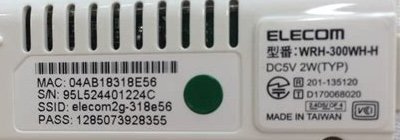

Finally got one! I recently read this paper (attached, remove .txt from pdf to open) where the author discuss finding a few algorithms. Sadly they don’t disclose the actual algorithms, which means that we have an egg hunt on our hands!
I found 2 files in the firmware for elecom's WRH-583WH2 named wpakey2.4g and wpakey5g. Loading them into Ghidra was easy and the decompiled pseudo code was simple to grab. Working with AI a bit, I was able to get a working python script of the wpakey5g algorithm (attached, remove .txt). Testing it in my environment, I am able to confirm that it correctly generates the key shown on the device. There are only a few entries for these SSID on WPA-SEC. Unfortunately the keygen doesn’t crack any of them. I tried using the MAC address +/- 6 as input but still didn’t have any luck. Elecom makes other models with the same SSID and different password format.
Known <MAC:Pass> from images:
bc5c4c2ced61:4772699470186
bc5c4c2d0085:4766205670098
bc5c4c2d016b:5367495178935
The wpakey2.4g is actually a different algorithm that uses “HW_WLAN1_WLAN_ADD” as input, but wpakey5g uses “HW_NIC1_ADDR”. I have been able to emulate wpakey2.4g with QEMU and it spits out "5108498128774”. A bin named “flash" is where the MAC address is pulled from NVRAM that’s used as input, but I haven’t quite worked out feeding it a known MAC to see what it puts out or what the default MAC that it’s generating that key for.

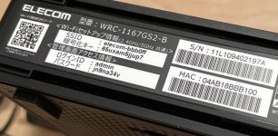

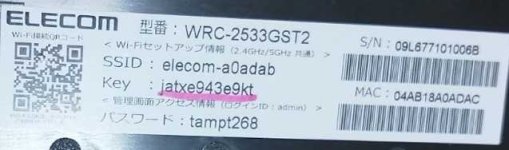

And since Elecom likes to include the keygen in the firmware, it might be worth it to track down other models from them. A quick scan of yahoo.jp auctions shows a wrh-300 and wrh-733 as prime targets.
254
366
3,695
@drsnooker The firmware that I found is a fantastic example for anyone trying to learn this stuff. It basically went how online tutorials show, find the firmware from the vendor site, unpack with binwalk, find binary and reverse with Ghidra. I have looked through a few more models, they all seem to be available online. I haven’t found anything else exciting other reference to gen-pin function that resides in the binary “flash” and is used for generating the WPS pin. I haven’t bothered to reverse that yet.
Elecom aren’t that interested though because they don’t seem widely used. However, the NTT has a lot of uncracked hashes on WPA-SEC. I found a few firmware, they seem readily available from the vendor but maybe they are encrypted now… or I haven’t found the right one yet.

According to the research paper, I am pretty sure Algorithm-4 is wpakey5g
"A value generated by a specific calculation from the AP’s MAC address is used as the default Wi-Fi password.”
Unfortunately the wpakey5g algorithm doesn’t seem to generate the proper password for these other devices, which likely explains why I wasn’t able to crack any of the WPA-SEC hashes. I need to finish reversing the wpakey2.4g, but that one calls srand() and rand(); I think that means I need to emulate it to retrieve the proper key. I just need to figure out how to feed it a new MAC and it will be finished. Algorithm-2 is going to be the one that produces the alpha-numeric passwords.
"The MD5 hash value of the AP’s MAC address is calculated. After converting the hash value to a character string, certain characters are deleted, and a certain length of characters from the beginning of the character string is used as the default Wi-Fi password."
