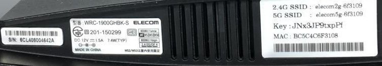

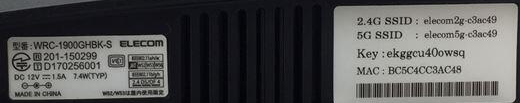

Ok, it turned out to be a little easier to feed the MAC than I thought. I just put the MAC in a file named flash in /tmp/ and ran this using the libraries from the firmware from inside the emulated environment.
PATH=/tmp:$PATH LD_LIBRARY_PATH=../lib ./wpakey2.4g
Here was my output based on the known MACs
bc5c4c2ced61:9152502417459
bc5c4c2d0085:6152490316548
bc5c4c2d016b:1681951111870
The binary produces the same generated key repeatedly, despite the rand(). Unfortunately there is no way for us to confirm these are “valid” keys, but I am fairly confident they are what the device would actually produce. I also don’t think these are ever used for this model, since there is only 1 key shown on the device (which is produced with wpakey5g). I also haven’t been able to figure out a python script that produces the same keys in my environment, so I haven’t tested any keys against the hash.
I was also able to find another keygen and confirmed the python script is working! This one was in WRC-X1500GS-B, a plain text file named mstc_ssidkeygen (attached below). To test it yourself use the MAC 3897A452D908 which matches the SSID.
Elecom Default Credential Generator
Base MAC: 3897a452d908
Derived MAC Addresses:
5G : 3897a452d90a
2G : 3897a452d909
WAN : 3897a452d90b
SSIDs:
2.4GHz Main: elecom-52d908
2.4GHz Alt: e-tomo-52d908
2.4GHz Secure: elecom-s-52d908
5GHz Main: elecom-52d908
5GHz Alt: e-tomo-52d908
5GHz Secure: elecom-s-52d908
Security Credentials:
WiFi Password: 47u44vt57e56
Guest Password: 27u24nt37854
Secure Key: p7u54ft37257
WPS PIN: 30295124
Web GUI Password: 9tu435u3

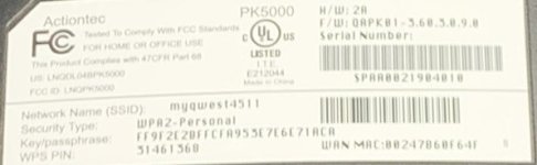

Check it out, I caught another one! This one was found in the TM3200M GPL source code (bcm963xx_31.164l.04_gpl_consumer_release) on the Actiontec website. Yet again, we find the algorithm lurking in the depths of /lib/libcms_core.so. The decompiled algorithm accepts serial number or MAC address as input, so it likely covers multiple devices. I have confirmed it works for Actiontec PK5000 using the SSID myqwest. Right now, my script recognizes the MAC prefix 00247B subtracts 1, and outputs an uppercase key. This matches what I’ve observed on the sticker, but was not part of the original algorithm. The rest of the code is unchanged so that we can find other devices. @Sparton I could use some help finding the other devices this covers.
Enter device Serial number or MAC address: 00247B60F64F
[!] Detected 00247B prefix — adjusting MAC (-1)
Generated Qwest SSID and WPA Key
SSID: QWEST604E
WPA Key: FF9F2E2BFFCFA953E7E6E71ACA
*Note: the generated SSID doesn’t match for this device.
  • qwest_gen.py.txt

@FiosFiend not to burst your bubble with the actiontec keygen but...
@Dawbs with all of fiosfiend recent additions we probably should add a non-zyxel keygen table in the default-wpa-keyspace-work-in-progress thread.
Not sure if @Plum wants to host the newly discovered keygens, or perhaps @FiosFiend can start a github repository. Attachments in this forum expire so when somebody comes across this thread in a few years it might be less useful.

@drsnooker glad you got some free time to play around! Yeah @RealEnder had informed me that you already found the actiontec/qwest keygen. The good news is @Sparton, @RealEnder and I finally put it to use and cleared a bunch of myqwest keys :smile: . I am not sure if you knew that it also generated the PK5000 keys too (just needs uppercased)
@Plum or whomever else wants to secure these scripts is welcome to do so, I share them here so that they can benefit the community.
@drsnooker great idea emulating flash! I did that for the wpa2.4key, but absolutely didn’t even consider doing it this time. I had never used qiling before, but your script was super helpful to figure out what was going on. Thanks for showing me a new trick. Please don’t ever worry about stealing credit, I asked for help and you solved the problem! My original decompile didn’t fully show how the math was being done (32 bit wrap around). but thanks to the emulation debug we now have a working python script that works for
WRC-1467GHBK
MAC (12 hex digits or colon form): BC5C4C70BBF9
Mode (1=default, 2 or 3) [default 1]:
SSID: elecom2g-70bbf9
Key : I4kEoISGQOa4
WRC-1900
MAC (12 hex digits or colon form): BC:5C:4C:77:63:81
SSID: elecom2g-776381
Key : xdDnr3znDLRL
WRC-1900-GHBK-S (MODE 2)
MAC (12 hex digits or colon form): BC5C4CC3AC49
Mode (1=default, 2 or 3) [default 1]: 2
SSID: elecom2g-c3ac49
Key : ekggcu40owsq
