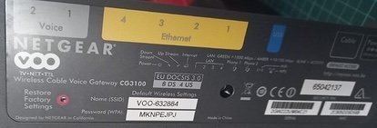

@PROger4everPublic your hits on VOO- led me to look for more of their firmware. Unfortunately I didn’t find any, however I did uncover an older keygen disclosure.
https://github.com/QKaiser/voodoo
Like we’ve seen in many other instances, the “solution” for the ISP is just to change the broadcast MAC. So I modified his brutepsk.py to build a SSID:Key look up table. With this, about 100 or so keys are generated for each SSID, allowing us to quickly crack it with the command (replace SSID.here with your SSID)
grep SSID.here voo_keys.txt | cut -d: -f2- | hashcat -m 22000 --stdin-timeout-abort=600
https://limewire.com/d/43zDe#YwEvj9Haxc

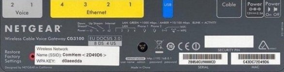

The device in question is a NETGEAR CG3100 which is ALWAYS rebranded by ISPs. If we could find the firmware, I’m sure we would find other keygens...
Numericable - 10 digits
BigPond - 10 digits
ConHem - 8 hex
Telstra - 10 digits Model C6300

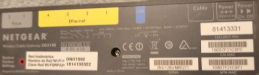

@Dawbs let me know that the download link in my last post wasn’t working so I reuploaded it.
And the confirmation photo that goes with it..
Here’s an other ISPs that use the Netgear CG3100
ONO - 10 digits (note the similarity between the security pin and WiFi key)
