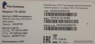

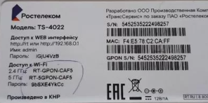

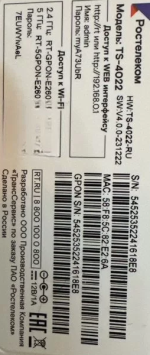

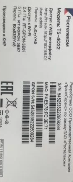

ROTEK2 SEED3 30189 MAC 58F85C , F4E578
@kasper9776 Do you have a picture of the router?
@PROger4everPublic did some research and said there are some collisions (the algorithm does not always generate a unique password for given seeds)
kasper9776
Apr 9, 2025
17
20
96

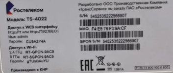

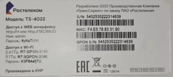

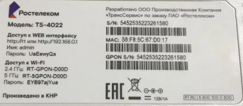

54525352241618E8:TS-4022:RT-GPON-E260:58F85С82Е26А:7EUWYivAeL:Rotek2-133
5452535222314639:TS-4022:RT-GPON-3186:F4E578833190:K3F84afj7U:Rotek2-133
5452535223261580:TS-4022:RT-GPON-D00D:58F85C67D017:EYB97ajYua:Rotek2-30189
5452535222566907:TS-4022:RT-GPON-9AC5:F4E578F09ACF:gTUyi3AuYU:Rotek2-30189
5452535222498257:TS-4022:RT-GPON-CAF5:F4E578C2CAFF:9bSXE4YkCc:Rotek2-30189
5452535222660769:TS-4022:RT-GPON-4BB1:58F85C0D4BBB:gSyeAYTeyU:Rotek2-30189
5452535222609284:TS-4022:RT-GPON-3E67:F4E578FC3E71:EXs63EiYV8:Rotek2-30189

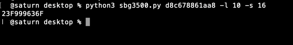

@Plum Any chance you can add another command line parameter to the SBG3500 algorithm to allow for users to change the start of the crop from hex_digest2?
I don't know how to do a pull request and I barely know python basics, but I think these are the modifications needed:
line 9
def SBG3500(serial, length,start):
line 58
key = hex_digest[start:start+length]
line 64.5 (insert new line)
parser.add_argument('-start', help='Password start', default=6, type=int)
line 67
SBG3500(args.serial, args.length,args.start)
So a function call for SBG3500('d8c678861aa8',10,16)
Would give: 23F999636F
Matlab has index 1, so that password starts in python would be 6,14 and 16. (instead of 7,15,17)

Yup I will work on this when I have some time. A bit busy lately so might be a bit.

Done.

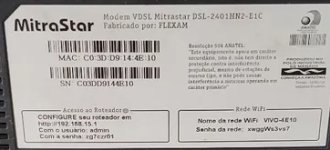

For the keen observers in the above table, there's a few dozen cocktail 14 passwords. It's a new one! @FiosFiend deserves the credit for the discovery of the firmware and decided to name it Quentão after a Brazilian drink. Here's a picture of an example. So far they have ESSID VIVO-HHHH
@Plum: I've update the worked out example data in the zykgen file to help you out. It begins with a new charset (ambiguous and non-ambiguous) as usual. But at the end does a post modification to make sure there is at least one upper case, one lower case and a number in the password. (The positions depend on the length of the password)
Mode 13 is the WIND3 mode2 that you have already implemented as a stand-alone so you can just ignore it if you want.

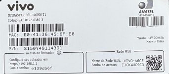

MitraStar DSL-100HN-T1
SSID: VIVO-
Gin and juice algorithm with Serial as input

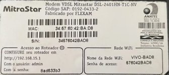

Mitrastar DSL-2401HN-T1C-NV
SSID: VIVO-
Key: Last 10 characters of MAC

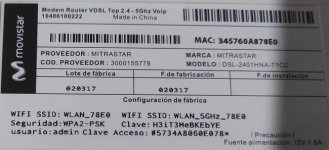

Mitrastar DSL-2401HNA-T1CC
SSID: WLAN_, SPEEDY-
Key: Gin and juice algorithm with MAC as input
MitraStar DSL-2401HN2-E1C
SSID: VIVO-
Key: This is the new Quentão cocktail!

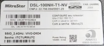

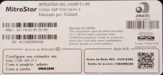

@FiosFiend Great summary. Those DSL-100NH-T1-NV are bothering me. They smell like Gin and Juice. Perhaps just an unknown seed, like a hidden serial number, or something else. Let me have another look at the firmware, perhaps there's a hint in it.

Unfortunately, I don’t know if we have the DSL-100NH-T1-NV firmware
DSL-100HN-T1-NV is a very closely named, but different device that uses the last 10 characters of the MAC as the key.
